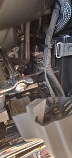

Seems BMW might be on to those of us that may wish to reinstate the reverser after its mandated disconnect - At least in Australia. Mine had both cable 2 and 3 removed. Cable 2 is easy - make a new one and connect it. Cable 3 however, goes to the wiring harness (somewhere). Nigh on impossible to work out where. As for Cable 4 - haven't bothered to remove the cover to see if it's been removed or not. If anyone has any idea's I am all ears...

Cable No. 3 is a Ground connection between the Reverse Control module and the Transmission Case; there are two Ground landing points on the transmission case.
You'll need to remove both bolts securing the footing bracket (pegs or floorboards) and the gear shift axle, so that you can maneuver the assembly in order to get to the Ground screw with an extended Torx tool.
I agree 100%, it is a little difficult, but absolutely achievable..
Outside of the diagram already provided earlier, which mostly covers the wiring of the Reverse Control Module (Terminal 3 - Ground); the below image shows the Ground landing point No. (4) on the Transmission housing, which needs to be secured (8 Nm).
As I mentioned earlier, I had to remove the Gear Shift floorboard bracket that bolts into the frame, and the Starter - Reverser Engine Cover in order to expose and gain access to the Torx screw which secures the Ground Terminal. NOTE: I had to use a six inch extension for the Torx bit. I remember seeing two Ground landing points when I was working on my Model B, as depicted below as Landing Points No. (3) & No. (4); you will land the Ground cable from the Reverse Control Module on Landing Point No. 4. and tighten to (8 Nm).
I hope this helps..
Below is an actual picture, showing the 12 Volt DC terminal landing point, as well as the "hard-to-get" Ground cable and the landing point on the Transmission housing; you're going to need a Torx with an extension in order to get to the Torx screw:
