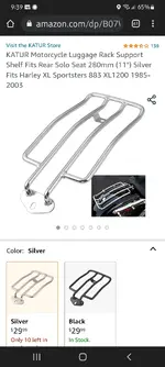

Drilling into fender needed ??
with this exact Rack form Amazon, There is No Modification , Drilling or Anything i did, Just A little Bending on the front rack using a Vise-Grip ( make sure to put towel over the fender so Not to Scratch it ). It aligns to the Rear hole using the OEM screw.......
