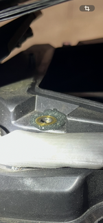

Those look like expansion inserts. They are designed to expand and lock in place when tight but are removable when loose. I could be wrong but that is what they look like.Performing a 6000mi service on a friends R18 Classic and joined here to find valve clearance and fastener torque specs as well as any general maintenance knowledge. This forum, like the others I am on, is a great resource. Started to remove the air filter and the threaded brass inserts for the air box lid backed out. I had to epoxy them back in and while searching this site found it has happened to others as well. Looking forward to searching the forum further.

I put some anti-seize on the airbox cover screws and didn’t reef them down like the last guy so they would come out with less effort next time. The DNA Stage 2 air filter mod looks interesting.crustyapo, same thing happened to me when changing the air filter for 6,000 service. Really frustrating to go through the laborious process of getting access to the air filter, only to have this problem happen to slow things down further. Next time, I'll switch to an aftermarket filter like the DNA Stage 2 that replaces the plastic intake box with a more robust metal bracket.
