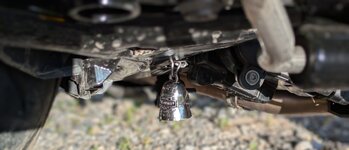

Some basic modification this weekend.
  • Removed the (ugly) orange front reflectors,
  • Added rear spacers, painted in grey metallic mate,
  • Replaced fuel tank BMW badges by custom ones (homemade)
  • Attached a guardian bell offered by a friend below the engine (as low as I could of course)
