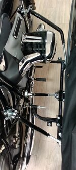

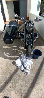

Anyway, have the jack under the frame, the gold ingot on the cilinder, took the locking pins out. The straight edges ready too. Tomorrow tie-wrap the latter and loosen all connections.
Align and retighten.
I am not sure I like the Rock mode with the chair fitted. Will try Roll next time. Same power just smoother. Befits the rig better I suspect.
Raining so perfect day to do some spannering.
Loosened all though not all at once to keep the lot from collapsing.
Set is up again, toe in with help of charming assistent and after .... got it right and retightened.

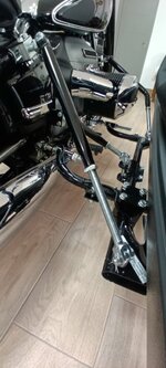

The short test mentioned earlier did point out that the steering damper works btw.

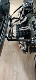

It is supersimple to correct but the booming economy means all are inundated with work so there is little/no interest in a 30 minutes faff.
The local ´welder´ dropped by at my place to have a look and he thinks it´s most efficient to roll up with his mobile workshop and modify the connection here.

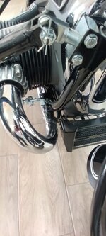

I am very véry glad I decided to use a sturdier rear bottom mount and a fifth mounting: The R18 is a rather a serious tractor.
The latter leads me to another observation: Some vintage ´torpedo´ model sidecars had a loop running from the wheel side chassis tube to the bike side tube. Anchoring the fifth mounting to thát would be a order more stable.

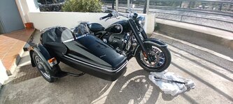

First véry tentative real test:
Only up to 50 km/h.
So easy. Só stable. If anything the bike rides easier than solo.
Mild accelerating and medium braking the sidecar is hardly noticeable.
Sofar happy camper.

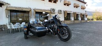

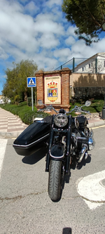

Today a drive through and around the village.
Drove a treat. Só smooth and stable. The chair is hardly noticeable but HÚGELY contributing to riding comfort: This village is all inclines at all imaginable angles and narow streets thus fantasy angled tíght turns. Rather a difference with navigating the >350 kg bike solo.
The reverse gear, imo a must on a rig anyway, is só :love:
Was a bit disconcerted by a ´shaking´ noise when passing over rough surfaces. Back in the garage think I identified it as the seat juttering in the lock. Will try some gaffer tape.

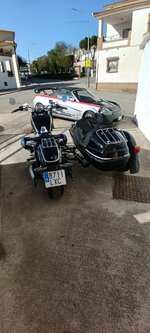

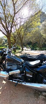

MUST mention the attention the rig draws. Just about all pedestrians stopped to look and when I stopped for the photo several walked up.

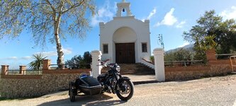

Yesterday evening drove to an exhibition and performance art by a friend. Twas up in Iznajar Castle (do look it up) high above the Iznajar lake.
The ride from Salinas to Iznajar is :cool: It is a continuous string of curves and bends with perfect tarmac and great views. As such nothing out of the ordinary here 🫣🤪
