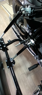

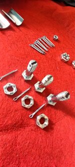

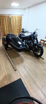

Been rolling about on the tiles to tighten bolts and nut. Will do a second round when I am satisfied with the settings and then fit the split pins. Did mark the bolt heads with the position of the bores for those.
My poor ti hips and shoulder not to mention my fractured dedo gordo of my left foot (dropped a ´gold´ weight on it).
Slowly but surely getting there though and when done will be proud as a monkey with seven tails and the wrath of now not so charming company will bounce of my adamantium skin.

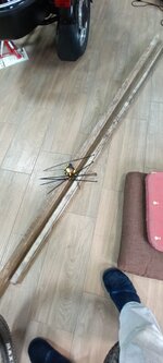

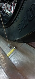

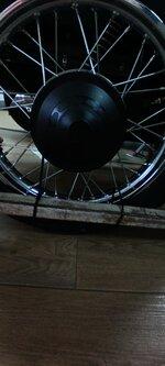

At the moment, before fitting the top mounts(lean out), I have a 123.5 cm track width, 34 cm. sidecar wheel lead and 15 mm. toe in. I hope to set the lean out at 0.5 degree.
For the moment done. Because this week we have rainstorms and extended floodings of roads so had to postpone the electrics.
Setting lean out;
The toe in:
