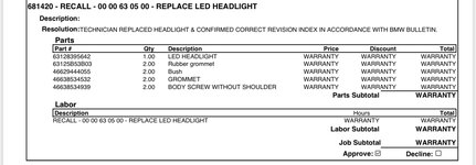

New headlight assembly. Replaced the stock bushings and added new ones to the other mounting points.
Soooo, I wonder if the actual headlight is the same? Same part number as the original, so far as I can tell. Did they just add some bushings to dampen the vibration? Fingers crossed that’s a true fix.

The headlight work probably took 2 hours. They said a new head light is included in case there’s wear on the old one from vibration. And yes, it’s a like for like swap of the light itself.
Wait, so it’s the same headlight? They just added rubber dampers to mounting points? If so that’s a huge bummer. Can anyone confirm this that is smarter than I?
