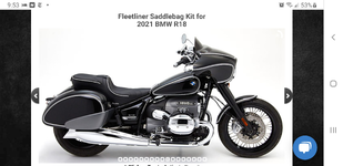

Corbin shows their Fleetliner bags mounted similarly
And those Corbin bags retail for roughly $2300-$2550 a set. I would recommend considering the long V&H slip-ons offered for the R18 when mounting those. Physics don't care much for the size of one's wallet.
Or you can get some heat reflective material if you have an issue with bags getting too hot. I had a problem with one of the cases on my GS getting overly hot on long trips from the exhaust, I put on a layer of self adhesive heat reflective fabric and it did a great job, and it's held up for 6 years so far.
