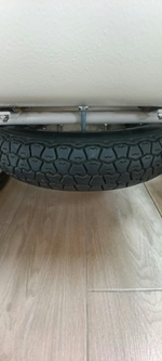

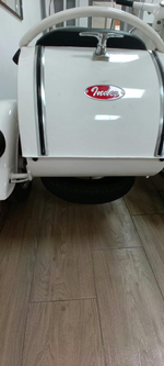

Since the chair is fitted as was customary on NSM Vespas, it is on the left.
Reason being easy access to the engine.
The down side is less easy access to the spare wheel. Mind, you can still get at it, it just needs more creative manipulating of the side cover and even then it is more convenient to take off the mounting strut.
So... started pondering about it.
Decided to fit it sómewhere in/on the tub. That would also improve the weight distribution.
As it does not fit ínside, copied common car practice and bolted it únder the boot.
The test drive confirmed a better weight distribution as the wheel now is perfectly located ballast
Clap emoticon

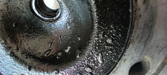

Not so fun was that some 100 meters from home the engine started running rough and I decided to kill it 50 meters further.
Pulled the cilinder head off and...
... it has eaten the big end bearing
Facepalm emoticon
