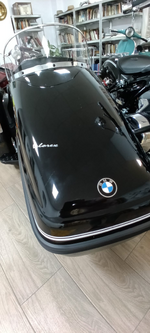

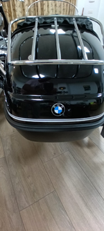

Thought long and hard about a seeming detail: To badge or not to badge.
The tub imo 'needed' a BMW badge as front and rear look rather bare.
The chrome border on the sidecar mud guard highlighted the effect of such a detail.
The issue is that a BMW badge is fake on a Velorex sidecar. I positively lóath that.
Decided on a compromise.
In the photos they seem, especially up front, a bit larger than the 45 mm they are.

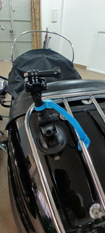

Getting on with the GoPro. Have the hardware sorted, the software installed.
Expect a learning curve for recording and probably need help with downloading/uploading because I use Linux.
