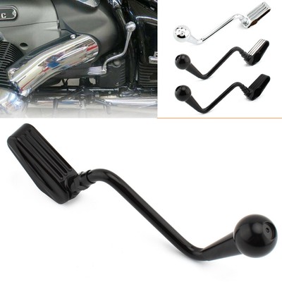

.....and get one of these groovy farkles. I makes shifting easier.
Not for me I’m afraid. Maybe through regular use or whatever, I have no issues with the short lever as supplied. Might feel different if freezing hands were an issue.
I often had problems with the reverse gear, and nothing since I installed this extended lever
May be it's the solution ?!!
The longer lever increases the torque you can apply to the handle. I’ve found a couple times on mine you can rotate the stock lever enough to engage the switch that shows it in neutral, but not enough to engage the mechanical bits.
