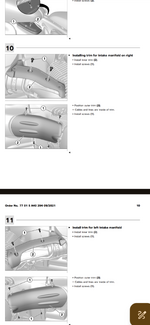

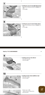

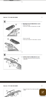

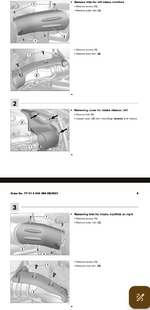

MilwDave - I had downloaded this a while back off of the BMW Motorrad/Service/Installation Manuals page; however, I can't remember from which bike I pulled it from. I have the PDF, but it's like 20Mb big and I don't think I can post it on the forum.
The screen shots should be enough to get you going.
I did .. it is 2 piece and a real pain in the rear to get back on .. the black piece right below, that are 3 pieces and I never did manage to remove the middle (rear) piece ...
