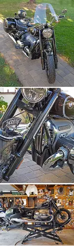

PistolPeteSTL
I honestly like the OP's rattle can job on the OEM guard best. I am considering some combination of that and black to bring out a "kidney" grill.
Thanks. I know that is going to be a high wear area of the bike and would need touch ups, so may as well DIY so it's easy to DIY the rock chips once a year or so. Anything put there is going to get beat up as miles are put on unless a new fender that sits lower is installed.
Gr8adv
I’m going to get the beach bars and the LMC swing saddle installed along with a few of the BMW RSD items this winter. I’ll make a list for next winter. I’m really getting intoLMC stuff and depending on finances I may go with their cooler.
This winter is almost over. Let's see it!
Since it will likely need touch-ups, you might want to try black PlastiDip. I often use PlastiDip on a part for awhile to see if I like the look/color and if I do, I just peel it off before I have it powder coated.
