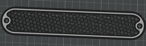

My son was over from uni and I have asked him to 3D print the ´1800´ engine plaques with open honeycomb back ground. The idea is that this will be extra air intakes. Should be about 20-30% (depending on logo design) more intake surface.
Imo it is essential to add intake surface if a sports filter is to be fitted.
My plan is to fit a Sprint sports filter and modify or delete the filter cover. Deleting would reduce turbulence but also increase intake noise.
Not fitting a metal frame. Just a dab of silicon will keep the filter element put.
The stock programming will adjust the mixture for the extra air flow. I.e. a bit more oompff with the same mixture parameters.

Not convinced on the use of a 3D printed plastic. They are more useful for short life objects. I understand that there are a lot of different materials available but just a word of caution.
I am currently looking at a 4 axis desk top CNC machine that could do that in metal. Just need to convince my colleagues that it is a good investment for doing prototyping.
If I convince them will let you know.
Thanks @Red64 Been using various materials for some 6 years now and indeed UV and temperature are issues as is material fatique but things have evolved húgely. Furthermore it si just side plates and can have him reprint a set.
@Noelpolar good idea if a sports filter is fitted and the lid removed or opened. You have no?! So have at it!
Looking at the air entry, the side openings should make a difference.
It is a simple thing to do at no cost and as easily reversible.

Ah and when fitting open side plates will try round the edges of the apertures. It is after all about marginal gains so best max the margins :ROFLMAO:
