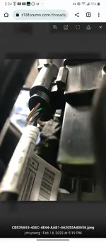

Finally getting around to doing this! Stuck on disconnecting the OEM tailight harness from the housing. See attached pic. Anyone know how to remove it? Thanks much!
That plastic joint unclips off of the larger plastic frame. It may be easier to figure out once it’s off.
Thanks MilwDave! Still can't figure it out! Here is another pic from the front. It's the rear light harness connector. Is there a clip somewhere I am missing? Driving me nuts! I think I lost 6 hours today because of this!
I’ll be honest, it’s been a few months but I have a foggy recollection that it just unplugs from that plastic union.

Thanks man! Will keep at it. Trying to do this without breaking any plastic 😊
I believe it’s held in place by the silicone seal.

Kinda hard to see in there even with a flashlight. Can't believe this is so hard. Clearly I'm missing something obvious. When done I think I will be crying and laughing at the same time 😂
Well I gave up and sawed the sucker off. Even after taking off the OEM tailight connector and looking at it I don't know how else I would've done it. Anyway, the bobber project is done. Everything seems to be working. Attached pics. Thank you @e66 and @MilwDave for your tips with the lighting. It helped tremendously. I bought the Wunderlich adapter which worked perfectly. Of course I had to give up the orange light functionality of the mini bates lights since the US bikes do not power those wires. But that's OK.
