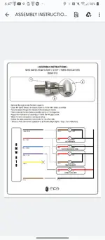

Your adapter most likely has a resistor. I am trying not to cut the oem wires hence looking at the Wunderlich harness.
Hey e66. I had a follow up question. Did you get the harness from Wunderlich America in NC? If so, is it different from the one shown in the wiring diagram which I believe is for the European market or the same ? Hard to get a clear answer directly from Wunderlich on this.You will only need two wires (ground and light) for the lights unless you tie both leads together to power both bulbs at the same time. The US models send 5VDC for running, 12 VDC for brake and for turn just alternate voltage to blinks the lights. I don’t think you will need the resistor If using the Wunderlich harness.
The LMC adapter was plug-n-play. I didn’t need to cut any of the OEM harnesses.Your adapter most likely has a resistor. I am trying not to cut the oem wires hence looking at the Wunderlich harness.

I have to put the fishtails back on my bike. That rear shot convinced me.Well I gave up and sawed the sucker off. Even after taking off the OEM tailight connector and looking at it I don't know how else I would've done it. Anyway, the bobber project is done. Everything seems to be working. Attached pics. Thank you @e66 and @MilwDave for your tips with the lighting. It helped tremendously. I bought the Wunderlich adapter which worked perfectly. Of course I had to give up the orange light functionality of the mini bates lights since the US bikes do not power those wires. But that's OK.
