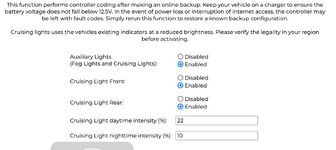

It is a setting in the ECU that I was able to activate where the front turn signals stay on at @ 30% brightness all the time ... kinda like the tail lights on the US version and just get brighter when the turn signal is activated. Something like this:
Unfortunately I didn't turn on the turn signals .. but you get the idea I am sure ;)
Oh and here is a screen shot of the page in the GS-911 where you can turn that feature on ...
