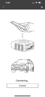

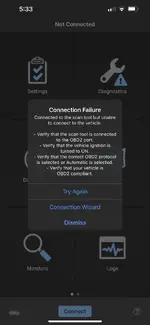

I just bought the obdlink mx+, but im having problem with…. Obdlink is not seeing my motorcycle. My phone is connected to the obdlink bia bluetooth but obdlink can’t see the motorcycle… any advise?

You are halfway there. Download Motoscan free app to your phone, upgrade the Motoscan app to Pro version somewhere around $30 (Pro version will let you reset the service light).
While the Obdlink is sync with the phone like you had it, now open Motoscan app Pro from your phone, from Motoscan Pro app select R series -->, R18 -->, K35 (Bagger) -->, Instrument Cluster -->, Servive Reset, from here you can reset it by date/miles. See sample from this video link
