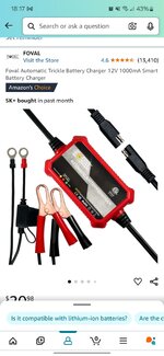

A tender will not bring a battery to a full charge once it’s been discharged. You need a charger to do that. Personally I use the NOCO Genius chargers to charge and maintain my batteries.
I used this actually.

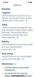

Some info on reliability of LiFePo4 batteries:

The issue is not the number of cycles or wearing out. On all three lithium batteries that failed, it was the BOS component that failed.
I was addressing your statement that lithium batteries are at the bottom of the reliability list. All 3 of your BOS failures on lithium ion batteries? LiFePo4 batteries do not have a high failure rate for the BOS or any other component, you must just be very unlucky.
