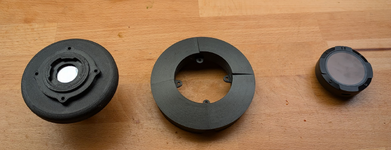

I purchased a small Beeline Moto 2 GPS and installed it on my bike using the provided holder. However, I wasn't very satisfied with securing the mount with an elastic band on the handlebar.
So, I decided to mount it on the fuel cap instead.
Since such a mount doesn't exist, I designed and 3D-printed one.
The result is a two-part mount.
The main part is permanently glued (with epoxy) onto the BMW fuel cap and holds the Beeline GPS. The top part can be changed and replaced if desired.
Here is the result.
Part is printed with Carbon fiber infused PETG.
Should be weatherproof.
Screws are not necessary, top part fits bottom part.

The "Base" is printed with black PETG+Carbon for maximum durability and weather resistance.
The "Top" can be printed with any material you choose.
Pictures show top printed in PETG+Carbon
