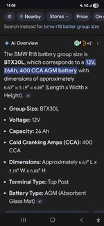

... off question ... does anybody happen to know what the frame size/designation of our batteries (FE/Classic) is? ... Should be something like ETX30 or so ... and if anybody has the actual (physical) dimensions and lug positions that would be nice .. and could you share please?
From Google.
I just installed NOCO NLP30 lithium ion battery. bought it on Amazon, $199. Amazon says it doesn't fit but NOCO says yes. I can confirm it fits. 15 lbs lighter. easy install. The negative terminal is left. 700 cca!
