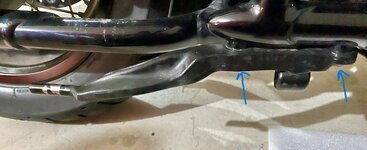

I wanted to give removing the exhaust a go. Not too hard to be honest. Once you remove the bracket, a little knock with a rubber mallet & firm pull got it out! This was an opportunity to clean and polish the insides. It did have a lot of asphalt & road grime. So here are the two fishes out their natural habitat :p
The exhaust/muffler supports are another thing. I couldn't remove the two screws! Too tight, or too much factory locktite :confused: they wouldn't budge & was afraid I would end up rounding themSupports.jpg..
