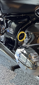

Do I need to purchase the D-Shape connector to Round-Shape adapter cable for the OBDLink LX unit; or does the R18 platform support both OBD connector types?
You don't need to get an adaptor, the obd LX is good to go for the R18... newer bikes has OBD-2 connector already like a car, just plug in...
Some OBD II connectors are on the right like my FE/2021 R18C.It is a pain at first to unplug.The later R18C's(& the R18s) have them on the left side and are easier to get at.
Be careful not to break the holder if you location is on the right.It will unplug easily if you pinch the releases correctly.Take your time.
