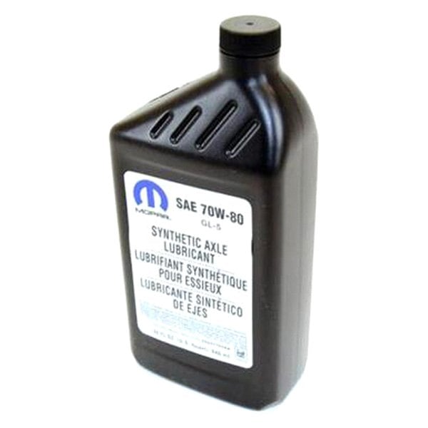

Provided for those coming after us --
I happened to find this SAE 70W-80 Synthetic API GL-5 at a far more reasonable price than the BMW brand, after I had already bought the other. 3 would cover both the transmission and rear.
