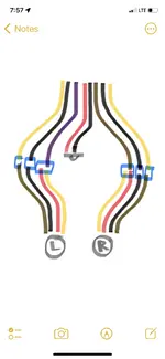

Great job, thanks for sharing the picture. I bought the same kit. Very poor instruction... ;-( My issue is to get the proper electrical connection. Match all the colours, but now my tail/brake light are amber/yellow... ;-( Any instruction on how you paired your wires? Thanks.
Thank you very much TodkaVonic. Support from WalzWerk isn't impressive...
Just to be sure, the black and red from the wiring harness are just left by themselves, or are they connected together?

Glad it worked! The red and black wires terminating in the thing that looks like a nipple in my drawing are the wires to the license plate light. Hook those to the white and black wires from your light. Regarding the error light on the dash, short answer is yes, it'll go off on its own after riding for a few feet. I don't know how to fix it so that it never appears upon starting. I experimented with dozens of combinations of various resistors but could never get it to go away. Of course, WalzWerks is no help. Enjoy the look and try not to dwell on the transient error alert.
Thanks, @TodkaVonic, for all your help. The only answer I got from WalzWerks was, "Go to your local BMW dealer." We've sold hundreds with no complaints/errors. My local BMW dealer answered, "You should have bought original parts and accessories from us."... LOL Anyway, won't be bothered by it. ENjoy the ride!
