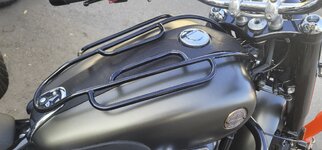

Got this gas tank rack / protector today.
Exceptionally well made --solid, not hollow tubes... adds function x2:
1) as a somewhat protection against drop of things on it.
2) as a rack to bungee cord tie down objects onto.
Plus...
3) Looks! - I like the look and it will match the black back fender rack where I took off the passenger seat.

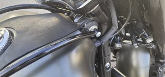

Follow up on installation:
The install was easy as you might imagine just by looking at it - 3 screws. The bend tolerance and length of the two tube prongs at the top are slightly off, maybe less of a bend on one prong shortens the over all length by 5mm but not enough to cause any hassle on install nor even noticeable.
However major caveat... The 3 screws supplied are cheap Chyna crap with grossly sloppy/off tolerances. See pics.
You will need to buy proper (standard) metric screws:
2 of the M6x40 for the 2 front section prongs and
1 of the M5x45 for rear of tank (hovers over the chrome piece)
Pops right on, easy peasy.

Been eyeballing these as well .. but am thinking it would be a pain to clean the gas tank under all that rack ?
Not at all... the rack hovers above the tank by about 1" so no risk of rubbing on paint either.
I can slide my fingers under it no problem.
The pic at preinstall, I was just laying it on checking fit I'll take a finished one today

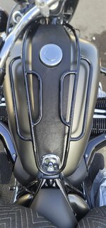

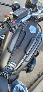

Finished pics. Black screws would have looked better but the hardware store didn't have them and I didn't feel like waiting on an order. Maybe I'll swap them out tho...
