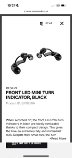

I have been looking at these beautiful lights. Just want a plug and play setup which i don't think these are. Something that just clicks in to the connector

Well turn of events, I just bought this bike and as it sits its at 61 miles on it so I didn't want to cut into the OEM connectors. Something about it being a cleaner install got me. I did find those BMW Light man they are small, but well built. I have not installed them yet, but will be soon. Waiting for a warmer day. These have the connector attached so should be a straight forward install and each connection.
It will take you less than 30 min....small lights; however, extremely bright...

I’ve used these; have to cut original wires and use heat shrink connectors. No issues with function.
I was able to keep the original OEM connectors, and tuck them up and out-of-sight.. maybe try that before cutting the connectors off and splicing the electrical connections...
