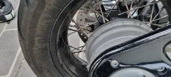

I have oil spillage from the final drive/bevel gear similar to the posted pictures

Dear all,
I want to ask you if you have in the US the same problem of oil spillage of the final drive as in Germany.
On our German Forum we have an opinion poll running and of 33 participants up-to-now 12! have this problem (including me, pictures are from me).
We talk here about a motorbike (although the 9 come from all production years) which is 9 months old, was never driven in rain, only hand-washed (no high pressure), never driven above 80 miles/hour with a milage of 3.000 now. So no special cause to be seen here. Certainly passed the first service at 700 miles.

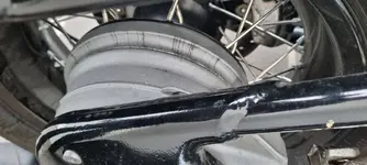

You see the spillage over the final drive in fine but many lines.
which reach the rims
and now it becomes dangerous also reaches the tire. When you look closely one line actually reaches already the tread of the tire.
Hell, how much to we enjoy oil between tire and asphalt :poop:
I have reported it to the BMW headquarters already.
So what I recommend is that everybody checks his final drive to avoid an accident. Several of our riders said they did not have the problem until they had a close look on the rim and final drive.
What would interest me how many of your bikes are affected as well. Therefore the poll.
Present causes mentioned to drivers from BMW dealers:
- during factory assembly too much grease was put into the final drive which comes out especially during long drive and hot weather
- rust: then typically the shaft seals or the whole bevel gear are changed

Dear all,
Didi can you tell us what has been the response from BMW headquarters since you reported the problem?
Have you tried phoning BMW Assist and demanding that they recover the bike and provide you with a replacement until the matter has been fully investigated and resolved as it is a safety issue?
You dont know when the leakage will occur again onto your tyre, and there is oil or more likely grease that should be there lubricating some parts which is no longer there doing its job, potentially leading to further mechanical failure.
