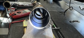

That is some pretty welding job Dave!! Why are you coating instead of polishing the stainless steel?Getting the finished exhaust ready to take to the coating company.
Conner is an artist.Damn that is a mighty fin TIG job !
That is just sexy!!!
Awesome!! Yes!! Who said that Harley is the only bike that is customizable!! And this coming from a Harley biker since 1970.I’m going for this look
La estructura de malla es hueca por dentro y está envuelta con una manta de fibra de vidrio. No es diferente del embalaje típico del silenciador de motocicleta.
Si bien no estoy presente en el sitio donde se está realizando la fabricación, supongo que esos dos orificios son para igualar la presión dentro del silenciador. Dado que esencialmente lo estamos convirtiendo en un sistema directo, las colas de pez actuarán como un gran escudo térmico y nada más.
Los tubos de dirección están completos. Retiramos el catalizador y los conjuntos de aletas, los agujeros están soldados.
Cuando se complete el trabajo, todo el sistema estará recubierto de cerámica de color negro mate. View attachment 13302
Hey Dave, did you scuff sand before painting black? Is that flat black or matte black high heat paint? Did you use the same paint on the exhaust and cat pipes? I think it would look good on my slashed cut fish tail!
We polished down a few of the welds and scuffed the mufflers. The coating company will sandblast them before applying a high temp flat/satin black ceramic coating that is rated to 1800 degrees F.Hey Dave, did you scuff sand before painting black? Is that flat black or matte black high heat paint? Did you use the same paint on the exhaust and cat pipes? I think it would look good on my slashed cut fish tail!
