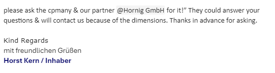

Fabricating a new handle (well, having on done) or perhaps more favourably an adapter made might be feasible. Kern Stabi replied and rather curtly told me to contact Horning...who did not supply the stand. I have done so and will keep you updated.
