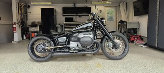

Awesome bike! So is your front wheel also from TTS? My bobber is currently 19/16 and would love to up size to a 17 or 18” rear wheel but if the spokes do not match I’d want to swap out the front wheel as well then.

The rear wheel requires new rim and spokes. As does the front. Both from TTS.
If you're starting point is a Roctane with forged wheels. You'll ALSO need hubs. Now it's getting very pricey. If your wheels are spoked you can reuse your hubs

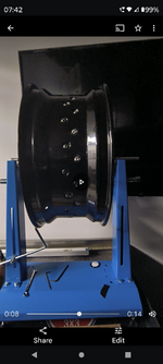

The offset for the TTS rim is measured on the DRIVE SIDE.
between the outer edge of the wheel bearing and the edge of the rim is 67mm.
I'm not sure how the holes are centered or not...i'll try to measure when I get Home in a few days. Looking at a video I have of the trueing they appear to be slightly offset toward the non drive side.
See the blurry screen grab
