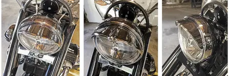

Absolutely ok, that's what this is all about. I couldn't remember the steps and didn't want to give incorrect advice, so I just went through it again. It'll take you less than 10 minutes.
1) remove headlamp. Unscrew these two bolts and detach wiring by sliding grey part of the clip away from the headlamp
View attachment 225View attachment 226
2) put the headlamp on something soft on your workbench then unscrew the screw at the 6 o'clock position
3) rotate the chrome surround counterclockwise about an inch and remove
View attachment 228View attachment 229
***mine has a little rubber bumper at 12 o'clock and I can't remember if it was there or if I added to keep things snug
4) place the visor lip underneath the surround lip then reinstall the surround. Turn surround clockwise then screw in screw.
5) reinstall headlamp onto bike, electrical clip first (lock into place by pushing grey tab towards headlamp).
Enjoy!
