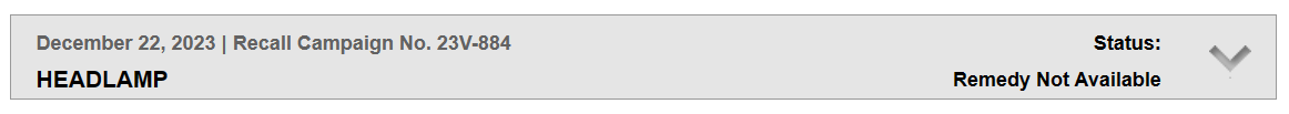

Link here for reference: https://nhtsa.bmwgroup.com/safetyrecall/pages/motorradRecallSearch.xhtml
Thank you for the link. I have a 2023 TC and a recall for the headlamp comes up when I run my vin. shows "remedy not available". I think you're right on what they mean by "voluntary". BMW wasn't forced to do that recall by a government agency.

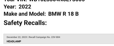

My 2022 R18 Model B broken headlight was replaced under warranty, this past 2023 Summer; I searched my VIN and it shows a "HEADLAMP" under the BMW safety recall campaign:
You’re the first I’m aware of with a replacement unit also caught in the recall. I’m feeling more confident that it’ll be all bikes with the adaptive light, replacement or not.
