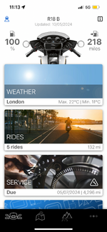

The SOS error is usually a software update (on RT's anyway) - mine had it. I have fuel gauge issues too but different in that my analogue gauge is more accurate than the digital display one- the digital one often reporting that I have a 190 mile range when full :rolleyes:
Cheers. I thought about that as well. Me being me, was afraid that if I were to ask for an update then something else would pop up later on 🤣🤣
Will do the fuse trick tonight and if no joy then will ask for a software update when I take the bike for a service in 3 weeks time. Maybe this will cure the analog fuel gauge issue and update the app display as well which as you can see says I have 100% fuel yet some 218 mls range🙄
