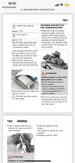

I will be trailering my R18 next weekend and thought it wise to inquire if there are any do's and dont's concerning tie down procedure. It's one of those things I do every 10 years. Couldn't find any threads on this via search. Will start with YouTube I guess.

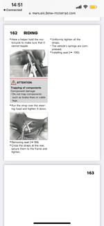

Under the owners manual, there is a small reference to the tie down procedure. Mine is on pages 161 and 162. Yours may be in different pages.
