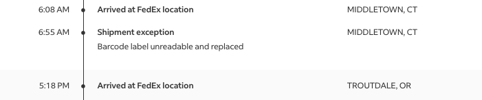

And a shout out to MAX BMW even with this happening
It still came here around the time the parts guy estimated ... nice.
