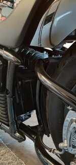

I wouldn't be surprised if it was more with everything I've gotten off it. I actually weaved the servo buddies up and into a different area, the plugs no longer even reside in the back rear. Same with the canister. Unweaved, and reweaved the plugs forward to behind the wiring box. Its looking way cleaner. I will definitely be going with a small lithium soon.
That's a good idea... I may play around with relocating the servo connection points up and out of any potential road spray or water damage..

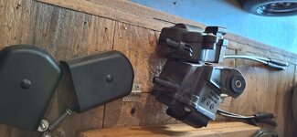

Ce n'est certainement pas le seul but. La perte de poids était surtout une plaisanterie. J'essaie simplement d'améliorer l'esthétique et de débarrasser la moto de tout point faible ou commande superflue, comme les servos.

As to whére it gets removed that is a tricky one because p.e. these exhaust servos are below the cog so removing those raises it. Again you are not going to notice but taking off low weight is not simply all good.

Weight loss was more tongue in cheek. Sort of like, parts falling off are generally parts that are emissions related, or for simplicity. Im not ACTUALLY concerned about the weight. It will be reduced, but this is more to clean up the bike and have less failure points.
