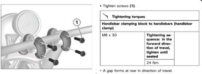

Grasshopper New member Joined Feb 12, 2025 Messages 4 Location Ontario, Canada Visit site Bike 2024 R18 Roctane Monday at 11:09 AM #1 Does anyone know the torque value for the Roctane handlebars? lb/ft (Nm)
Star-Lord Well-known member Joined May 11, 2024 Messages 1,151 Location New Jersey, USA Visit site Bike R18 B Monday at 4:54 PM #2 I'm not sure if this helps, this is the torque settings and handlebar installation procedure for a Classic (not ROCTANE):
