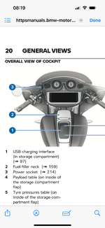

Hello, I would like to connect my Quad Lock inductive module with a bare wire that allows 15W charging for my phone (only 10W for USB connection model)
Is there a free accessory socket somewhere at the front of the R18B?
Pierre
Yup. The cigarette lighter type is on the instrument dash at the left hand side. It has a flap to keep it shut. It is number 3 on the diagram.

But I would like a permanent connection somewhere behind the dashboard to keep this socket free
Same socket; you can disassemble the dash and route the wiring from the Quad Lock and electrically connect it in as a parallel circuit.
It's only the two wires I assume, a (+) positive 12 V and a (-) Negative ground connection. See call out bubble No.5 within the below image.
