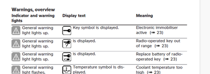

Tried to start this ‘21 I’m thinking about buying. Got the battery to 100% on the trickle charger. Power on and lights come on but won’t crank. The message on the dash shows a key sign with a ? Underneath it. We swapped batteries, 2032 I believe, and still same results. We also removed the seat and placed fob directly on the circle “doo hickey.” It will click but not turn over. Still has the ? Regarding the fob/key. Anyone experience something similar. I read one thread where it talks about the voltage on the fob. It also claims/recommends you use a proper BMW battery for the fob.
