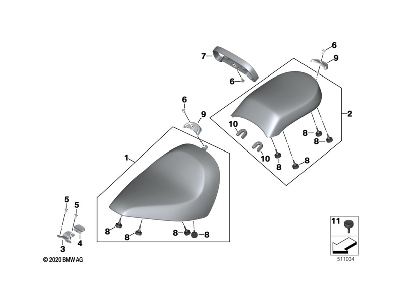

I just entered the world of R18 and unfortunately, I am stuck with the installation of the passenger seat option 719. Does anyone know the code of the support plate which must be installed (apparently sold separately) to support the seat?the seat on installation side.jpg

You need the part number BMW 52538403749. It is part 7 on the schema below. Some screws (2 x part 6) are needed too.
