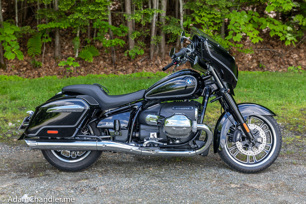

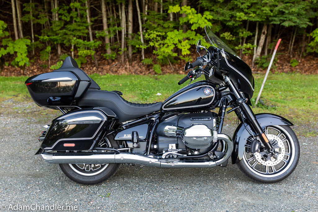

Some photos for you:
STOCK:
TC 760MM seat added:
Top Box Added:
I also put together a video on how to do this and showing off how the heated seat now works. Pillion has their own button which is convenient. No shoulder taps asking you to heat up their ass.
