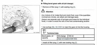

Interestingly BMW part no. 83222460128 G3 oil is specced for the R12 series as well and 75W/90 is commonly used by BMW dealers instead. I am okay with using this in the final drive (shows on past paperwork), so just need to know opinions on using it in the transmission. I also note that the R12 series were specced with 75W/90 until G3 came on the scene around 2019/2020 and were then specced with G3 using exactly the same mechanical components. Sounds very much like the BM cash machine in action. This is from my 2017 RT - SAF-XO is 75W/90
Just found this on my 12k service invoice, BMW 75W/90 oil used in the final drive by the Motorrad dealer.
