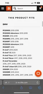

Which one of these part numbers can be used for the exhaust flapper mod? Both are being used by different guys on this forum. I dont see how both can work?
I dont see how they can both work?
See the previous Post by LongShot; he has installed the Servo Buddy modules on three R18 bikes. He provided a RevZilla link which points you to the model pictured on top that you provided in your original post. Personally, I like that design vs the module with the wiring pigtail design; I think the top pictured model looks cleaner.
Post in thread 'Exhaust Servo' https://www.r18forums.com/threads/exhaust-servo.1435/post-26383
Attached are the fitment tabs on both parts.
Since they are similar, I would say go for it, but I'm just taking an educated guess.

I think the distinct part numbers have more to do with style and form rather than function. So far I have not seen any mention on this forum of error codes popping up with either one.
