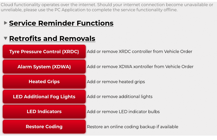

Hexcode just updated their GS911 software which has a new option to add an alarm.
YOUR GS-911 DIAGNOSTICS AND GS-911WIFI WEB APPLICATION FUNCTIONALITY​
This update now provides you with the ability to configure your motorcycle's electronics (code the Instrument Cluster, Body Controller, and change the Vehicle Order) for the retrofit or removal of the following accessories:
- Alarm
- Auxiliary headlights (aka LED fog lights)
- Heated Grips
- LED Indicators
This provides you with OEM functionality on any BMW motorcycle with the K001 chassis and is accessible from the Selected or Detected vehicle menus.

I installed one on my CE04 scooter. I assume that all of the bikes that are capable of having an alarm as an option are pre-wired. Used the GS911 to program it.
