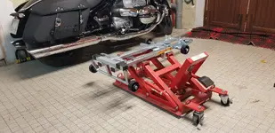

I myself use the Kern Stabi system and a high lift pallet truck.
During last ride I made a stop to take a picture of the bike and guess what ?
I realised I forgot to disassemble the Kern Stabi system, Oooops !
It fortunately did not cause any incident, see attached photo!

You mean you rode around with that thing under the bike?
Just a 10 km ride in town, no damage at all
i bet you won’t forget that again. Your set up seems complicated but has lots of benefits for storing the bike upright and conserving Space, also for maintenance and cleaning with the lift. I am very blessed and have lots of space and a regular bike lift, but because the R18 doesn’t have a center stand I did get a Wheeldock to keep it upright when parked.

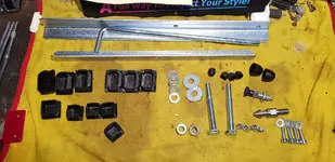

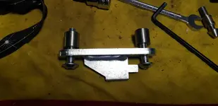

Installed the Dr. Jekyll & Mr. Hyde Kern-Stabi exhaust adapters (X518-JH) for the X518 stand today; it's pretty straight forward, where it replaces the existing BMW Torx threaded bolts which land within the frame in order to support the exhaust muffler brackets. These bolts are reused when installing the Jekill & Hyde exhaust system; however, replaced when using the X518 stand and the X518-JH adapters.
Pictures showing the stand landing points for the adapters; the adapters stay permanently installed on the J&H exhaust support bracket. The orange arrow calls out the notch-catch which is located on the Right-Hand-Side of the X518 stand:
